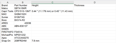

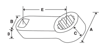

I'm looking at getting a torque adapter set. I'm looking for something that is thin walled and extended box with some vertical height.
Unfortunately there are only a few manufactures that make this tool. I have tried to compile what I have found so far for metric. As you can see the height and wall thickness are not listed online.
If you have any of these sets, can you please reply with some of this data?
  • Vertical height of the box end, meaning dimension C.
  • Wall thickness of the box end
  • The hex size (i.e., 10 mm, 11 mm, 12 mm, 13 mm...)
If you find any of this information online, can you please post the source?

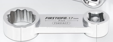

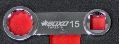

Tools that look identical:
Version 1
MATCO SBTA10MR
Capri CP31510-10MT
MAC SXBM102H
Boxo BX574-R2
ARES 43036
ABN ABN-830137
Sunex 910MTAS
FIRSTINFO F3451A
APEX ATCCAA0270
1734496236030.png1734496286969.png1734496352051.png1734496519117.png1734496536157.png1734496611434.png1734496466353.png1734496952073.png1734497207560.png

Version 1 all look identical
I suspect that Version 2 is the lowest overall profile on the square drive end.
Version 3 to be unique and helpful in some situations
All them look to not be "extended box", and low profile on the fastener drive end.

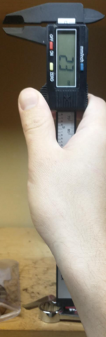

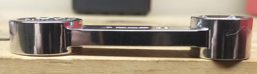

Yes. But due the limited amount of options though, it should be easy to study the market, to determine which set is the best for the needs. Unlike other tools where there is so many options. So I figured I would give it my best shot.
I did find one 6 point extension, and it's only 14 mm. It's a Snap-On. It's the only 6 point they make, and the only 6 point that apparently exists at all, even looking at other manufacturers.
Anyways comparing the overall tool height at the fastener end
ARES 14 mm
So more or less identical to the 12 point snap on.
I also found two additional sets, ANPUDS
I'm concluding that at least dimensionally, all the sets are more or less the same, except for below exceptions:
  • DISEN which is flat on the square drive end, but has bad reviews on Amazon.
  • MichaelPro is for damaged fasteners and is black steel
  • ANPUDS is black steel
  • Snap-On FRSHM14 is the only 6 point variant on the market, and is 14 mm size only.
