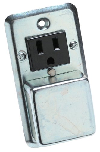

Bussmann #bp-sru Recep & Fuse Holder
Just mount it in a handi-box.
Finding the "right" fuse could be a challenge. When you start reading the specs, you will see that a fuse may have to exceed its rating by 100% to act "quickly". A 10-25% excess would pass current for a "long" (minutes) time. These are standard fuses, not "slo-clow".
