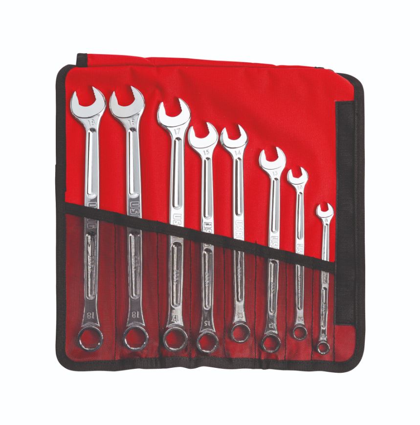

The new RBRT is available in the USAG brand for cheap around 150$. The only real problem is acquiring them is almost impossible, can't seem to find a vendor that ships to the USA. Well for me it is easy as I live in the UK.
USAG partnumber 285 X/SE12
The USAG use the exact same profile as the MAC? That's interesting and tempting. 8 piece set is 115€ including shipping from Italy to me...
yes from the pictures on the Usag website, they are exactly the same wrench. What website are you using cuz I haven't found one that offers to ship to the USA. I bought the 8-piece set from Facom for about 70$ but, not bad either. bot are excellent wrenches.
I saw them here:
95€+ postage.

I saw them here:
95€+ postage.
nice, dang nice they have both sets thanks. yeah, that's a good price on both, 150ish for the complete set. wish they sold individual wrenches. i need a 12mm(work on Toyota).
