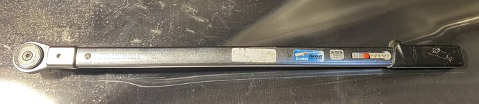

I woke up old the other day, and now I can’t do what I used to do.
Got the tires rotated (and some other repairs). Wife came home with the paper that says “torque all nuts to 140 lbs after 50 miles”.
Got out the torque wrench, it’s about 18 inches long, goes to 150.
between the knee, ankles, and wrist, I just can’t get to 140.
I searched here and elsewhere and got no definitive answer.
Can I use a pipe over the wrench to increase my leverage?

No. Do what I did. I went to a local tool store and bought an extra long one that goes up to 250 ft lbs to replace my old 250 lb one from OTC. It has a quick adjust handle too. Can't remember the brand name. I have an electronic one that's a bit shorter but it only goes up to 150 ft lbs too. Haven't used it in years but worked good when I did. It had a beeper that sounded when torque was reached.

If you want the capability to do this in future get a digital torque adapter and whatever length of breaker bar you like. If not, swing by the tire shop you used and they'll probably do it for nothing or a small fee. Around here a lot of tire shops will do that for you even if you didn't get tires there.

Conventional wisdom says to push away from you as opposed to pull towards you to prevent injuries.
How long is your current torque wrench?
24" is about as long as you'll find in 1/2" drive without getting into pricy specialty models.

Exactly. Use a digital torque adapter and use as long as a lever as you need. Breaker bar with cheater pipe, no problem!
I got the previous version of this, took it to work where we had a calibrator and it was very accurate.

I push down to tighten lugs, mainly because it's easier on the back.
Trying to get 140 ft-lbs out of a 150 ft-lb torque wrench isn't easy unless you're a gorilla. Just get the 250 ft-lb capacity wrench and move on. It's got a significantly longer handle. I don't have a truck, but the wheel bearing pre-load on my Subarus has been 137 ft-lbs, and I've used my TQFR250 for that job without difficulty.
The alternative would be for me to pull out my 3/4" torque wrench that has a 1/2" head on it. That goes to something like 350 ft-lbs, so my kid could reach 140 without too much trouble.
