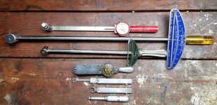

Here are a few of mine. The top one is a Snap on 3/4" Torque multiplier. Next are Ammco and Blackhawk torque indicators. A Plomb 5402 and Craftsman 3/8 inch lbs beam wrenches are in the middle. Bottom of pics is a Williams Measurrench with the original 64' sales slip and cardboard instruction sheet. Also a Craftsman 1/2" round head fine tooth Digitorque wrench I bought new in 79'. Ed.

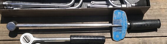

Here are my modest additions, Beemer. From top to bottom, there’s an APCO-Mossberg (1/2-inch drive), a Duro (3/4-inch drive), a Thorsen (1/2-inch drive), a Snap-on (3/8-inch drive), and three Richmont pre-set click-stops.
I’ve posted the Richmonts before.
As one could guess, they are way older than 1973, when Richmont and P.A. Sturtevant merged. The spinner/nut driver has a 1/4” hex. If you’re interested, I’ve posted more photos and info on my Richmont thread, linked here.
The Thorsen is fairly common.
The Duro isn't as far as I know.
The APCO-Mossberg is military with a wartime patent and FSN. They were a major suppliers of special socket drive tools to the Ordnance Dept. This one has a clutch-type ratcheting drive stud.

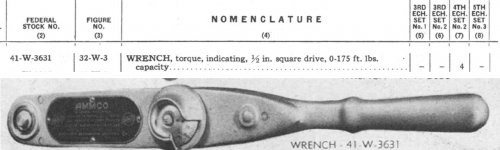

Oldtuleguy said:
Here is my old Ammco clunker
Your "old clunker" is a WWII torque wrench issued to 4th Echelon Set No. 2. Basically, that means a depot in the rear, typically a fixed site. Where major repairs and overhauls were done. I have been hoping to run into one in the wild for quite some time now with no luck so far.

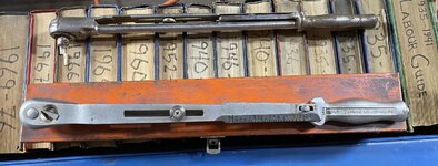

Not sure of the model number but seems to be military issue due to the markings
It is definitely military. Those are federal stock numbers. The first number (41-W-3631) is from WWII. The second 11-digit number is from no earlier than 1953. I posted a similar one upthread. See post #7. Mine has only the wartime FSN and a clutch type ratcheting drive stud.

Good information, thanks. So you would date this in the mid to late 1950s then?
30,658
I would say it's closer to 1952 and no later than 1953.
The first Federal Standard Stock Catalog was administered by the Treasury Dept., believe it or not. From the 1930's through the war up to 1952. It's too esoteric even for Wiki to know about it, but trust me, all WWII collectors are very familiar with it. Class "41" was hand tools. The middle letter was phonetic, hence wrenches, whereas screwdrivers were 41-S-xxxx, and so on. The last set of numbers (in this case, 3631) was the actual stock number. And there are all kinds of manuals that cite these numbers. In 1953, several joint service pre-cursors to what would become in 1961 the Defense Supply Agency began a new 11-digit system. Class "5120" was hand tools.
What's interesting about your torquer is that it has BOTH numbers. That tells me it was stamped in a time of transition. Hence, why I would not put it much past 1952 or 1953.
