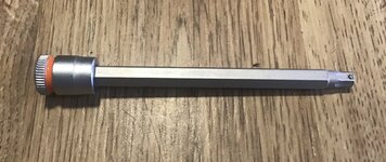

I have some of these by Wera.
I’ve had mixed results with my 3/8 drive. The interference fit seems good enough on the smaller screws, but if you get a big screw with a T30 head, especially a shallow one, I find they don’t really grip enough. Certainly not enough to hold a screw vertically.
On the upside I didn’t buy these for the holding function, they’re just an inexpensive set to keep in my road box.
I’ve had much better results with the 1/4”. These are newer tools so it’s feasible Wera improved the design. These hold anything I’ve tried.
The hex bits with the detent ball work very well. In practice, none of these tools are being used with big screws. If it’s a big screw you don’t have the problem.
I’m very interested in the Bondhus now. I’ve always had good results with their tools, but I detest the rough (is it “proguard”) finish they give some of their tools.
