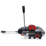

Has anyone added a 3rd function to your tractor?
If so what did you use?
I have a Massy Ferguson 2606 with a 911x loader and want a grapple but don't know if I want to add a 3rd function of just get a set of hoses to go to my rear remotes.
PCustoms
Jul 23, 2011
23,684
VT
I did I diverter valve off my curl circuit.
Pieced it together and saved $$$ over the kits. Only pain was figuring out the fitting type/size

AGCO does have a 3rd function kit for it
but its expensive.
I ran hoses back to the remotes before switching over to a dedicated valve. It was a pain in the ****, requiring tying the hoses up so they didn't catch on anything and of course requiring unhooking / rehooking when running implements such as my 3 point blade.

AGCO does have a 3rd function kit for it but it’s expensive.
“Expensive” is subjective. I selected my local dealer and it was a shade over $1200. Honestly was expecting more based on your comment. I paid that much or more for the Deere kit for my 2038r and it all bolted up without too much drama. I’ll happily pay a little extra for something that should fit and has hard lines and such vs making an aftermarket kit work.
Firebrick43
May 12, 2015
14,381
West central Indiana
Its more "expensive" than an electric solenoid spool kit from someplace like summit but yes, I too would prefer hardlines. I am not a fan of the universal kits mainly for the excess in hose but many put up with that
The 3 spool monoblock valve I put on mine I plumbed every point I could with hardline and JIC fittings but it wasn't a kit. I only have to remove two lines to get the loader off instead of 6 as well by mounting it on the loader frame.

Um,the power beyond valve can't be operated the same time that the master valve is being used, that is how all power beyond works on a open center hydraulics system. A path to tank has to remain open at all times, if the path to tank is closed the positive displacement pump dead heads and that is not good for the health of the system. If the valve down stream wasn't cut off when the upstream valve was actively in use you couldn't make any pressure.
Only a closed center system can have multiple valve bodies function at the same time because the pump stops pumping (variable displacement) if all the spools are closed as there is not path to tank.
Diverter kits don't allow for the the third function to work the same time as which ever circuit is being diverted either.
The only way to operate all three or any combination of the three is to have a 3 spool valve, usually monoblock like I posted above or a modular valve which is common with john deeres going way back into the 60's
