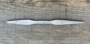

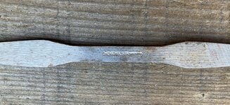

I have an old tutorial I made years ago.
It's all very simple, but the rule of thumb is that if you do it (probably on old, used auger bits), choose only bits in good condition, with intact side cutters, the screw intact, clean them thoroughly, and finally, the side cutters must be able to cut a piece of paper.
Furthermore, even if it seems demanding, if it's well-sharpened, the physical effort required to drill the hole should be minimal, and the edges should be clean.

Screws have always been a problem. Older models had coarse-threaded screws and fine-threaded screws. Only if the screw is in good condition can it be used; otherwise, discard the tool. After all, we're not talking about something impossible to find. If it's part of a set, however, you might be able to find a new bit.
If the screw has a coarse thread, you can lightly re-thread it with a triangular needle file, which can restore the thread and create a new end.
