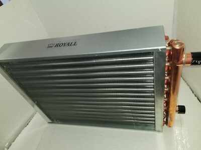

Just another idea of mine. I looked at this thing and thought this might work.
It's rated to 175PSI
Its made out of 3/8" copper tubing with 5 passes so its highly unlikely to get cluged. I figured it just need to fabricate a shroud to attach a 16" electric radiator fans with a ground temperature switch.
What do you guys think?

Back in the late 90's Ford trucks with the 7.3 and that era a/t were junk. Long story short with a lot of experimenting with gauges & various coolers it was amazing how much cooler it ran with Amzoil. Iirc that was worth 60* alone.
Can't comment on the wood boiler coil but I don't see why it won't work, but if you're having transmission heat problems, try Amzoil. Possibly any synthetic will help, back then Amzoil was about the only game in town as far as synthetics go. 👍

You might want to check your transmission specifications first. You mentioned that cooler is rated to 175 psi. In the past, I've researched a number of transmissions and the coolant line pressure was often in the 200 to 300 psi range max. I'm not sure a 175 psi rating is enough.

My truck has the Vortec 8.1 5 speed Allison. The cooler inside the radiator is leaking, lucky i only got ATF in the coolant and not coolant in the ATF. A buddy of mine gave me a Hayden 1290 cooler that i mounted with two radiator fans but my temperature climbs to 195F on long stop and go trafic when the torque converter doesn't have time to stay locked.

Admittedly I haven't spent any time w/ auto trans coolers but engine oil temp of 195F is actually too cool. I just did a quick search and see recommendations ranging from 150 to 250 for ATF. It seems to vary by trans make/model/personal opinion. What is the standard for ATF for your trans?
A transmission repair shop told me to try and keep it below 165F

Where did you mount the cooler, in what orientation, and with what fans? Is the transmission completely isolated from the exchanger in the radiator end tank now?

Long manufacturing, makes the patented ( or at least I think it used to be ) stacked plate trans coolers, that the OEs used mostly on trucks.
B&M sells them in capacities of up to 30k. These things are near bullet proof ( for the intended application ) in comparison to the conventional tube and fin ( spelled fragile ) aftermarket coolers, ie Hayden. The Longs, also are rigid as all get out, with mounting flanges top and bottom, they DO NOT mount on the face of another cooler, which Ive always thought was a really bad idea...
Id not bother trying to re-invent the wheel.
I have an 01 PSD F250, with a cooler made for a 03' or later PSD ( about the size of the radiator ). I cant get my trans hot, or burn the fluid now, and my truck is pretty much a dedicated tow rig ( full disclosure, I installed a Tugger 2 shift kit at the same time ). I drive a silverado for a DD. I did bypass the radiator OE cooler. I bought the OE cooler for convenience, not durability. Id have used a Long, if Ford hadnt make a massive cooler for the Torq ****, like they did.
Yes the transmission is completely insolated from the radiator.
The cooler is installed with the inlet and outlet pointing up and it's in front of the ac condenser monter as close to the grill as possible to allow the two fans to be monted behind the cooler as pullers.

I bought one of those and i returned because the inlet and outlet are about 1/4" my truck has 5/8" lines

Yes, but I have the OE, that Mishimoto is likely better quality,... honestly dont remember the size, seem to think I ran 3/8" hydraulic hose to the OE steel lines, with some kind of brass adapters to get to a barb fitting. I also installed one of them small inline filters, I just change it every year, which is likely crazy, I dont think I put 5k miles on it a year.
Looking at that Mishimoto it occurs to me, the unit I have is probably for a 2004 up S/D, and Mishimoto, is selling an upgraded replacement for 2003 down ( which is essentially what I did ). That unit may have different size fittings on it, to better suit the older trucks, but essentially that is exactly what mine looks like in size and mounting points, etc.
Its been too long for me to remember how big the OE cooler on my 2001 was, but seems to me the replacement has 4-6 times the surface area. It was crazy bigger.
