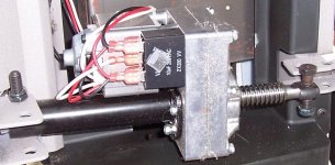

I got a treadmill to use as parts. The PO said "The belt squeaks when it's running" so gave it away.
I wanted it for the motors, as this one also has the lift motor, as well as the main treadmill motor, and I'm hoping that can be used, possibly as a lift motor for a DP table.
There are other parts that can be converted to shop use as well and that's after scrapping the steel frame itself.
So here is the 'raw material": A fairly typical Treadmill 12 years old or so.
After taking covers off, the motors;
The lift motor is a basic gear reduction screw drive. I've yet to got inside it to see if the drive nut can be easily replaced, the screw MAY be an industry standard... roughly ¾ X 6 TPI, but seems more rounded than typical Acme thread. It is a straight 12V AC/DC reversible motor.
And the goodies: the treadmill motor itself. This is a good one as it has dual rating 2.5HP @ 130 V AC (or DC); and 1.5 HP @ 90 V. It's also a good motor to use as it had a VERY easy to reuse mount. Some have complex mounting arrangements and are a pain. This one will be easy!
The card nearest it is a MC 60 (Motor Controller) and used Pulse width Modulation (PCM) to control the speed of the motor. The other card is primarily for controlling the lift motor, and may or may not be needed. For the Main motor it isn't. and the lift motor can be controlled with a brute force three position switch, but I want to see what features the control card has before scraping it.

And after it was all disassembled and I reconnected the basic wiring.
From the power cord module you will see the black wire makes a U turn, and that is to route it through a circuit breaker. From the CB it becomes blue, and tags the lift motor controller, then from there goes through the set of blue wires on the motor. Those are for a Thermal Protection switch so if it does get too hot it will shut off the motor at the MC60 control card.
That could be bypassed and ignored, but them you lose the Thermal protection so I'll leave it in place.
Once the blue line hits the MC60 it runs the thing and ultimately provides the main power to the motor. this is via the now black wire and through a heavy choke, (no that think is not a transformer. I think that drops the voltage a bit to 90 V to make the motor last longer. Hopefully an electron pusher will check in and verify/clarify)
On the MC60 controller note the three smaller Red/Black/White wires coiled up. This originally went to the main control board that I have already scrapped. This will be connected to a 5K ohm potentiometer (Pot) with the white wire to the center post of the pot, and the Red (Hi) and black (low) and will be used to adjust the speed of the motor. If the pot is "backwards" to rotation of the pot vs. perceived speed, just reverse the red and black.
All that is really needed to make it work however, is the motor and MC60 controller, with a pot added. You can bypass the rest and simply wire a plug directly to the MC60, and the motor to the MC60 outputs, and go!
Startup can be a bit tricky, typically the pot has to e in the “fast” position to start the motor. This is hard on whatever the motor is connected to, so adding a normally open momentary switch and then you can start at the last set speed.
BTW an easy way to spin the motor flywheel/fan off is to starting at full speed in reverse! (stand clear of the flywheel however!)
