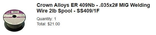

You can order a 2lb spool of ER409Nb weld wire online at Baker's Gas & Welding. The local welding supply houses did not carry it in TIG wire and the smallest roll of MIG wire available was over $230 for a 30 lb. spool of 0.035"MIG wire. I paid $21 for a 2 lb. spool. A bit more expensive per pound, but I didn't need 30 lbs.
That being said, when I asked the local welding suppliers what they were selling to the muffler shops to weld 409 SS exhaust, they all said ER70S-6 was all they were buying. I wouldn't use it myself because the welds will eventually rust out and crack before the pipe and I was using it on a small airplane exhaust that kept cracking the welds when ER309 was used.

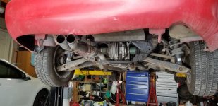

I'm working on this.... 2000 miata with an amateur paint job and a fart can eBay special muffler.... I have a more appropriately sized muffler and going to have it exist in the right spot.... Working from the resonator back....
.... Need help cutting straight with the portaband as well..... My cuts are wandering a little bit..... Although 2nd one was better than the 1st...20191216_140106.jpg
