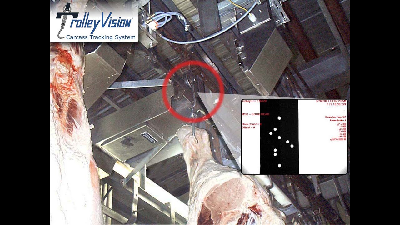

Tack some angle iron ^ atop the flange, and run a couple of these on it
29XU90_AS01
You might also want a top limiter so it cant bounce off the rail.
Slaughterhouse rail is often a single track hang as well.
