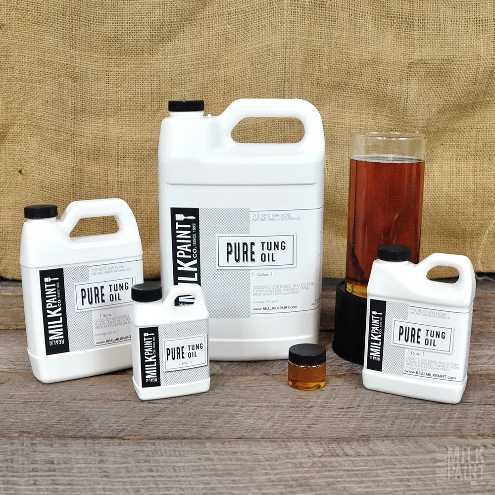

I recently saw a garage/shop floor and I asked the guy about his floor finish. He said it was Tung Oil. I really liked the look of it and he said it was holding up great for him. It was a woodworking shop, so not a mechanics shop but still it looked good and he had a lot of equipment in there and moved stuff around on wheels. I think he said the brand he used was RMP. He said it was a bit of a process to install because it took several coats to get to the point it stopped absorbing and then has to cure for a few weeks. He said it was super easy and pretty much fool proof, so very DIY friendly. He made it sound like if you do scratch it you can just buff out the scratch and apply more oil.
No idea how durable it might be but it did look nice and seemed decent to me. Anyone have any experience with it? I would consider doing it other than I have so much **** in my garage I don't know how I would ever make any finish work...maybe I could try it on my patio. I could likely get stuff off that long enough to seal.
