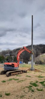

Little update on this thread as I'm still using some of the links.
Installed my 25' tall, 1/4" wall galvanized light pole. Will have an RCA rotator up top for antenna, WeBoost cell booster, and up to four 1500W Metal Halide "yard" lights.
This is the antenna I just ordered: Directional Antenna
With an overall length of 93" it should help with cleaning up some of the signals.
Under ground runs of 2-RG6, quad shielded cable, comm cable for rotator and couple 12-2 runs for power.

We currently have a cheap antenna mounted less than 1/2 the height (16' 2x4) of the new pole and get a decent number of channels.
Hard to think this new setup will be worse.
