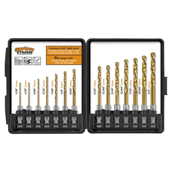

^ that's a new one for me. sending an inquiry to the factory now. web site looks like they're making product in house.
including 1/4" hex drive bits?!?!?!?!?!?!?!?!?!? o_O
Montana / Montana Brand Tools, 34837 Innovation Dr., Ronan MT 59864 / https://www.montanabrandtools.com/ / est. /
interesting 'test' video at lower right on this page.... not sure if this is a "real world" scenario or not:
