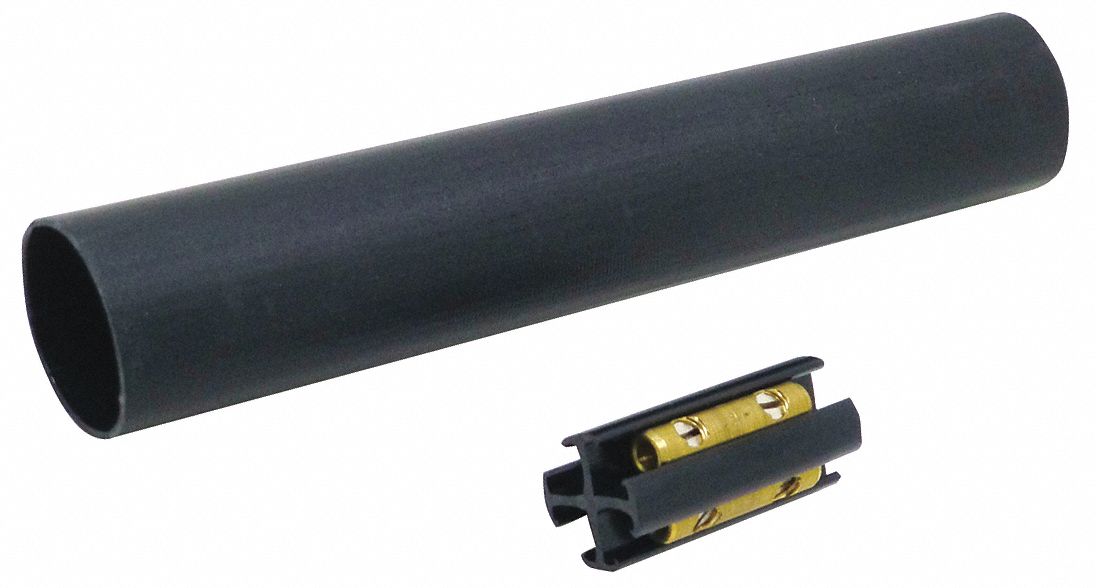

I'm not sure folks are making an issues about splicing #6 or #8 wire. IMHO, the biggest issue is having a box big enough to house the splice and extra wire.
The old fashioned method is split bolts.
View media item 33173
Use the proper size. Use 3M splicing tape or 3M friction tape.
The Ideal 46-400 is actually for underground, but no reason it can not be used above ground. Handles up to 8 gauge.
25A179_AS01
For larger gauge wire, use Tyco Electronics individual splice blocks, one per conductor, up to 1/0.
View media item 33174
