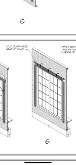

I recently had a water come in from above one of my windows during a storm. After removing the top trim (inside of the house), I could see it coming on the tyvek. The tyvek is stapled to a 2x6 that's above the window frame. The house is a brick wall, then tyvek and then osb board, insulation. From what I understand the tyvek should not be stapled towards the inside of the house. Should I be trying to see how to even fix where the tyvek is attached? That would mean ripping out the brick wall I think. Where do I go from here?
I believe I found where the actual water intrusion happened in a brick transition and caulked it. I also had someone examine the walls with an infra red camera to see if there's any more issues, but everything is dry

Mason made a mistake it sounds like.
When the lintel is placed at the window head, the mason installs flashing on the lintel and tucks thus under the tyvek /slit as needed. Then puts weep holes at the brick to lintel joint.
This turns out all the water over the lintel and none passes down to the window.
Other approach is to imbed Z-flash in the bed joint above the window. Z-flash is still tucked under the tyvek.

So the only way to fix this now is to open up the brick, put some kind of flashing there and then put the wall back together?

So this is a wood frame with a full brick veneer?
There should have been flashing to the front of the window up the wall, under the house wrap.
Brink veneer is a bit of a pain as you can get water and moisture between the brick and sheeting.

The WRB (Tyvek) overlaps the top window nailing fin; not wrapped into the jamb.
When there is a brick condition, the WRB overlaps the lintel not left behind it.
When there is an odd window such as an arch, an embedded tray or Z-flash is used.
I think you are removing masonry to fix this.

Yes, wood frame, OSB, tyvek, brick veneer.
Unfortunately I can't tell if there is a flashing (since there's no way I can see behind the brick).

Outside picture
Well, that wasn't quite what I expected!
With that window recessed so far I wonder where the water came from? I hate to say it, but probably from well above the window, unless it ran down the outside of the bring and water tension carried it to the top of the window.
I might leave the trim off, or with a couple small trim screws so you can keep an eye on it. Trouble is some times these leaks need the perfect storm of the right amount of rain and wind from the right direction.

Masonry has a nominal 1” air gap behind it. This is the drainage plane. Masonry is not impervious. Flashing needs to direct and steer water while weeps let it out.
Window flashing is wrong in my opinion.
I had success one time by injecting closed cell foam to seal off the air gap at a leaking door. We drilled holes thru the bed and **** joints above the leaking door and injected it. We drilled holes such to create a semi pitched slope with the injection. It stopped the leak without masonry removal. We did have pointup at the mortar joints where drilled. This was 10+ years or so ago; I’ve no idea the long term success of this method so can’t say I fully endorse it. We did it only because the brick was discontinued with acknowledgment by the customer (house was out of warranty but a courtesy repair by us).

I think you may be correct. The water may be coming from much higher on the wall.
Yes, I think the water was coming from the transition where one kind of brick transitions to the other. I rrcaulked it there and in the last big storm 2days ago I didn't get any leak. I also tried to run water from garden hose and no leak ar this point.

Yeah, that's not the right way anymore. Chasing a leak behind masonry is a tough one. Are there windows or doors anywhere above the leaky one? How was the transition from the brick to the stone handled? Is this "stone" what we call "lick and stick" (fake)?
Do both of these "soldier" courses (at the stone transition and around the window) have positive draining away from the wall?
This is where I'd start looking, it's the easiest, non destructive place to start. Some brick is surprisingly porous and it doesn't take much driving rain to have a problem, and a solid 10* outward pitch needs to be on all created ledges. (Soldier course)

As the very first picture shows, there's another window right above. I think the brick that looks like rock is not real rock but rather some sort of brick.
I redid the caulking around windows, the brick transition and every little hole I could find. I ran water from garden hose over it and we had another big storm and no leak.
What I'm not sure is if to call it good here since the water intrusion was stopped or try to figure out something with that (most likely) missing flashing.
