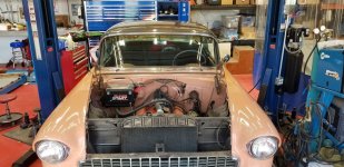

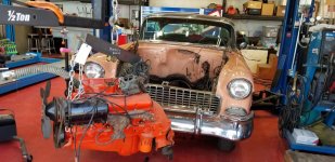

I also began the build on the engine more on that later.
Any way here is where I am at today. Pulled the car out and got the engine and transmission out of it, removed the exhaust system and disassembled the front interior sheet metal. I will get it cleaned up, painted and ready for assembly in the next couple of week,

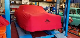

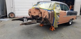

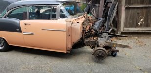

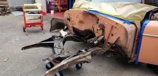

So I built a dolly that indexes into the sub frame and will let me set the chassis at finished ride height.
Preparing the firewall for clearance for the big block and stripping off the suspension for the rebuild:rocker:

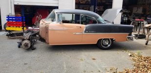

Prepping the front to install the new suspension and drive train. Will be modifying the firewall to make room for the Big Block and the new Vintage Air.
:rocker:
