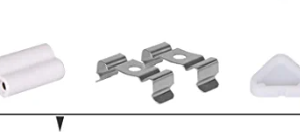

What have others done here? I've noticed when I have a car stowed on my lift, which is 90% of the time, it's pretty dark under the lift. Lift goes up to 6'9" under the ramps when all the way up and if I try to work under there on anything other than the car on the lift, it's fairly dark. Rest of garage is pretty well lit up with 6 UFO lights up high and I'm adding some other lights over the garage door, but it'll still be dark under there.
I've added a power strip, under the ramp by the ram, so I have easy access to power. I also just added lift lights to light up the top side of the ramps, so while working on a car it isn't so dark. Now I need to contend with the under side shining down.
I'm looking at linkable LED tube style lights, but want to see if other good options. Thought about LED tape lights as well, just worry if I use them too much they'll burn out. Kind of thought about putting these on a smart plug, so I can turn on/off with timer or by voice.
Here's one option I've been eyeing, just have to insure they will clear the cables and such.

I used LED linkable fixtures plugged into the power strip I installed on one of the posts, (fed from an overhead receptacle) I attached three magnets to each fixture using a strong glue, the fixtures mount to the underside of the ramps.
They can be removed in seconds and used for under car lighting when I am servicing a car using the lift.

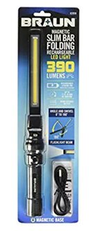

I found that my underhood light will reach the channels on most 4 post lifts.
I will often grab an Astro 40sl or 120SL and stick them to the lift for light.
I like the idea of linkable LED lights mounted under the lift pointing down, if they're magnetic they could be moved to where they provide the most light for the task at hand.

I used the Amazon tube LED lights with the metal clip on fastener. I then bought some magnets with the 3M VHB adhesive. I put the adhesive side to the lift. My thinking is that would keep them in place. The magnets held the lights in place. Not a perfect solution, but TONS of light. I used magnets with swivel clips for cord management. Then a coil extension cord for the up and down free-play.
I also did the same on my 2 post for extra lighting.
