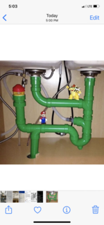

Thanks in advance everyone, this is the sink in our new home; its a double tub with a disposal on one side. I'm installing a single tub sink (cant stand double tubs!) and will need to redo the plumbing slightly. The plumbing install isn't the problem, but i'm stuck on what this second pipe coming from the floor is for?
Primary drain flow path is in blue, what I'm removing is in black, what I don't understand is in red. Does anyone know what pipe is for?

It's a vent.
Ah ok ok , that makes sense. so definitely don't plumb the drain into the right side down pipe! haha
Is this in an island?
Looks like your vent pipe to me.
It is an island, didn't know that was a factor but makes complete sense now! learned Something today. thanks!
I'll have to figure out how to plumb the new piping. The drain in the new sink is almost where the current left-hand drain sits. But now with a disposal going there I may need to get creative.
Any tips or things to avoid when it comes to plumbing in the disposal? (don't do too many turns/bends?) Do I need to keep the drain height above the disposal drain? it looks tall in that picture for a reason....

Great opportunity to get rid of the disposal. They only cause problems as the best thing you can do is not send food waste down the drain.
Make sure you have a horizontal section between the trap and vertical section of drain down through the floor so you don't create an s trap

Depending where your final drain is on your new sink and how the current disposal is set up it almost looks like you can get rid of a lot of the blue line... go direct from disposal outlet to your drain connect. You might have to reroute your vent line (red line) a bit, but it shouldn't be too much of an issue. The biggie might be removing / relieving the bottom of your undersink cabinet to fit your disposal motor, as it's tall...

Pick a single bowl sink with a drain on the right hand side or switch to a studor vent to clear out some space.

I don't believe my island is vented like that, going to have to look tonight. Is that a regional requirement or is it a new thing? Our house is just over a year old.

Not the only way to vent an island sink, but a good way IMHO. Regional preferences may affect this. Im somewhat guessing the island or loop vent is loosing popularity and air admittance valves (a Studor is one) gaining popularity, caused by greater code acceptance.

What OP has is exponentially better than a studor vent. A studor vent only allows admitting air into the system. When you add water into a system, the air (sewer gas) needs to be displaced ( vent through roof).
Post #5 shows a very good way to vent an island sink. Unfortunately all too often I see the vent line simply go back down and tie into the drain only. While this isn’t technically correct, I believe it’s better than a studor vent. If you look at it as a combination waste & vent system (it’s not really but would work similarly) it would be perfectly legal. I’ve never worked anywhere in my 45 years that a studor vent would pass an inspection. Maybe in a unique situation you might get an inspector to turn a blind eye.

Air admittance valves are acceptable by code. I'm not sure exactly how long but probably 5 to 10 years. I've never needed to use one but frankly, wouldn't hesitate.

Looks like a poorly installed island vent to me.

The cut out of the counter is limiting us HEAVILY on the replacement sinks. and we arent ready for a new counter top. Its a new build home so want to keep the builder warranty for the 2yrs. its active.
The vent loop needs to be above the sink drain as shown in the 5th post.
There isn't really any room behind, or to the side of the sink for this. I climbed in there and its really as high as it can go sadly.
The zip ties and several escutcheons scream homeowner hack, but the pvc belies that a bit. Odd setup for sure
This is the builders doing. is there something I can show them, code wise, that would require them to rework the piping and water lines?

Possibly the vent lopp height, but they will say it passed inspection and to pound sand. The rest is just poor workmanship.
If you have paid them, you are on your own at this point, IMO
