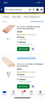

Need to buy 2x4 wood to frame bedrooms in my barndo. What’s the difference in wood types and best for my application?

Jokingly in wood grades here, there is #1, #2, Stud, and firewood. Spruce stud grade here, has knots, blemishes and is really prone to warping. There has to be a reason the other is more expensive. I would go for it.

I'd go with the cheaper ones and either hand pick or buy from a lumber yard where I could trust them to hand pick.
They will be fine for your use.

For non load bearing framing, which I assume this is, go with Spruce/Pine. Easy to work with, doesn’t split like Hemlock.

SPF … whitewood … has become the interior wood of choice. Lighter, cheaper than traditional studs. OP is east of the Rockies … SYP … pine … should be easy to get.

The whitewood studs are generally higher quality (i.e. straighter) in my experience. That's all I buy for any non-structural framing. I don't have time to dig through the whole pile of even the Douglas fir 'prime' studs to fine somewhat straight ones.

For wall framing, I agree that the SYP stuff I've seen is much clearer and straighter than the SPF. For load bearing sistering of structural joists and rafters, the SPF is lighter, stronger and less likely to split, even if it isn't quite as pretty.

Whitewood is barely superior to a dry sponge. If these are just for partition walls (i.e. non-load bearing) just get the straightest lumber you can find and don't worry about grades. Working with warped/crooked lumber is bad for the soul.
