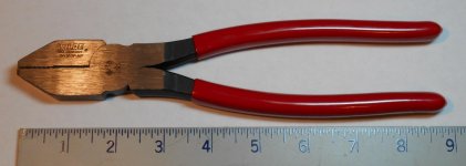

Yeah that would be a much more effective tool for cutting steel wire or nails. If you look at the mechanical advantage (distance ratios to the pivot point) it's about 20:1 for that set and only about 6:1 for the ones pictured in the op.
You got it. I cut that coat hanger to bits in about 20 seconds using one handed pressure and the cutters still look good as new. You can turn right around and cut fine stranded copper wire cleanly. It just takes the right cutters.

Go to Tractor Supply and get a set of Fence Pliers - the slipjoint wire cutters on them are made for cutting fence wire, so they'' handle stuff like coathanger, plus they have a better mechanical advantage than sidecutters...
THe ones you want look like this and run about 11 inches.
Cool, I'll be working with coat hangers (cutting and shaping custom sized hooks for cargo netting on my roof rack). A couple of those should do the trick.
