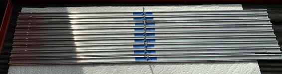

While all of that was drying I focused on the aluminum trim pieces for the drawers. They had scratches, some corrosion, and some staining from the drawer rust. I wet sanded the scratches and stains out with 320 grit and mineral spirits. Then I cleaned and polished all the surfaces with 000 steel wool, also wet with mineral spirits. After a final wipedown with alcohol, I painted them with 2 coats of satin clear.
To enable painting of the fronts and backs, I taped roofing nails inside the back grooves. I held the nails while painting, and then inserted the nails into predrilled holes in a board to hold them while drying.
Nail "handles" taped in place:
Trim cleaned and painted:
A
