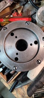

20241010_173812.jpg20241010_161927.jpg I recently received this Union tool Co three jaw Chuck for my metal lathe and I'm trying to determine the best way to go about adapting this to my lathe, currently the spindle on my lathe is a 1-8tpi thread, the chuck and it's current form uses a 2-1/8 5tpi thread, would it be better to make a spindle adapter or cut the welds off the flange to make a backplate?

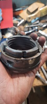

I'm not seeing any welds that need to be cut. It looks like someone welded a spindle nose protector to a disk of steel making a backing plate. With the screws removed from the front the current backing plate should separate from the chuck. Then make or purchase a new backing plate..
One example of what is available. Scroll to the bottom of the page.
There are other tool vendors who also sell similar backing plates.

There are no screws in the front of the chuck.

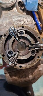

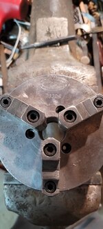

Before putting too much work into this, tighten something in the jaws tight and check for bell-mouthing. Those jaws look pretty worn.
MShaw
Mar 2, 2015
1,016
York, Pa.
Beyond new jaws the scroll could be worm as well as the fit between the scroll and the body. Also, the slots the jaws run in can wear. The first two will affect runout and the last will affect bellmouthing of the jaws. Check everything carefully before you start putting money into it,

Get something straight.. preferably a test bar and chuck it up repeatedly keeping the bar in same location rotation wise and check readings.
Or chuck up some solid stock, take a cut and keep re chucking the piece keeping it in exact same location in jaws, take your readings.
You want a 3 jaw to be repeatable within reason.... that's the point.
As stated above, there's many places for wear... if it looks old and worn it most likely is.
4 jaws are a different story. Rough rule of thumb, used 4 jaws can be ok, old used 3 jaws not so much.. better to buy new.

If the scroll and jaw slots are not worn past being serviceable, the removable top jaws can be reground to remove the bell-mouth. Do you have someone local that knows how to do that?

The best way to regrind jaws is to drill a small (1/4") hole in the front face of each jaw. put a pin in each hole. Cut a slice of an appropriate sized pipe. Chuck the pipe by the three pins then grind reaching thru the pipe slice. This will true the jaws in the bellmouthed position.

All kinds of videos on jaw regrinding. Some use equal length spacers between the jaws, others use pipe on the outside of the jaws and use the scroll to put outward pressure on them, though I don't think that is the right way to do it. The idea is to load the jaws equally and grind the working surfaces straight again. At one particular diameter anyway, lol.
On my Logan, I tore apart the factory chuck and cleaned it, only to find it bellmouthed due to slop in the slots rendering it practically scrap.

I would do the test I detailed above before buying anything or grinding the jaws so you don't get into a bad money after good situation.
If the scroll is worn, new jaws/grinding wont do you any good.
For the most part regrinding helps get the jaws contacting the work their full length.
