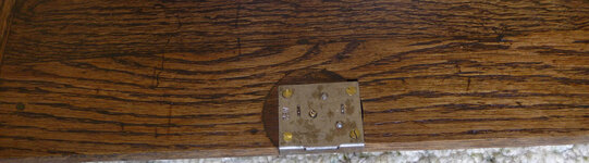

I picked up this old girl from an estate sale. It's a Union "Handy Garage Chest" from 1919. She was missing the handle and 2 ring pulls. The good news is that I found the front before leaving the estate sale. (they're almost always missing) The bad news is that the front was in bad shape. (loose joints, corner brackets and a hasp added, missing the lock/key, an ugly notch cut out and multiple holes. Fortunately all drawers and carcass was solid as a rock. I made a handle from scratch using a steel rod, lots of narrow strips of kraft paper and a hand sewed leather covering.. Locks are unobtainium but I had a vintage Corbin lock that I modified to work and filed a working key from scratch. The finish is about 6 coats of really thin hand wiped danish oil. (Sam Maloof's formula). I found a handle ferrule from an old CM steel toolbox donor.

Terry Rushback has an excellent tutorial on the handle recovering process. But to get to that point you need to bend a 5/32" steel rod to the correct shape and then wrap it with a gazillion 1/4-3/8" strips of Kraft paper to get it to the correct shape and then seal it with shrink wrap plastic film. It's easy but quite time consuming.
Ebay is the best source for old locks but I've never found a round Union original.

Too bad about the cylinder lock situation, but guess what, I have one. It’s not perfect and could be considered a junker, but it’s original. The back mounting flange is 2.10” dia. The barrel is .59” dia. With your expertise I believe you could save it. I made a key for it and it would lock your chest.
It was originally for a Union chest and had 2 pivoting hook-bolts for locking the lid. The hook-bolts and lever tumblers are missing and there are a couple other glitches. If you’re interested, I’ll send you some pictures.
