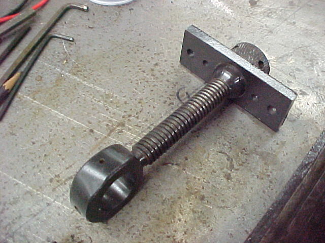

The process I used to clean this up was to soak the parts in Simple Green for 15 or 20 minutes then scrub the parts with ScotchBrite and a toothbrush to degrease them.
After degreasing I hit most everything with a flap wheel on the 4" grinder to knock off all of the big rust.
Then I soaked everything in Metal Ready to remove the left over rust and get the parts ready for Black Oxide.
Starting the Black Oxide dip.
This went pretty quick once I got the thing apart... Everything is Black Oxided and sealed.
I wire brushed and Metal Readied the handle to get it ready for paint. I sprayed it flat black to sort of match the rest of the body. That will be the only thing I have to finish tomorrow. I will spray a couple of heavy coats of matte clear on it to seal it up.
It's still wet in the pic.

Nice job. How well does the oxide hold up? Any special prep required for it?
Where did you get the wedge to separate the jaws? Looks like a useful tool that I don't have.
What are the plans for the missing jaw?
Thanks Matt,
The black oxide is a kit I got from Caswell. It is holding up just fine on a few other pieces I have coated with it. The instructions say to have everything squeaky clean before dipping and they are right. I have found the process I am using know works very well and I get good color on most everything I coat. The clear sealer is key to make the coating less permeable.
the pics I posted last night were with fresh sealer. I'll get new pics today while I am assembling it. You will see the look is almost perfect to hot black oxide without the hassle.
I have had that wedge for many years... I have no clue where it came from. probably in a box from an auction. i used to do those those a lot.
There are no missing pieces to deal with, everyhting is there. The big problem with the vice was the rusted slide.

The rehabbed vise is altogether and it looks and works great!
Wouldn't even recognize it from it's former sadness...
When I brought it home Friday afternoon...
And now just two days later. All cleaned up and fully useable!
It went back together easily and the slide NOW works as it is supposed too. It does take some effort, which is good, as that means it is still pretty tight. This is a very fine addition to my collection.
