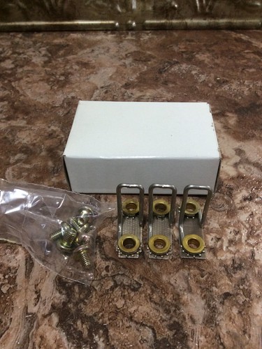

Looks like a C995A heater is required, there are used equipment dealers that sell heaters/ thermal elements, I bought a Rockwell 6" jointer with a 3 phase motor, swapped it for a single phase motor but the Rockwell LVC (Low Voltage Control) starter used a GE overload relay, I still have not bothered to source a new one as when GE was carried at a local supply house they did not handle GE's industrial controls now nobody has any GE locally.

...I double checked and I did not find any reset button on the motor.
Your nameplate clearly states "MOTOR NOT THERMALLY PROTECTED", so no, you will not find a reset button. ;)
Close, but you made the same typo as the ebay listing I found.
The heater is CR123C955A
This guy's selling a 3 pack:
They can be found on Amazon too:

The heater pictured? I doubt the number on it is the model number, but you're right in as much as any numbers on the heater pictured are not on the chart.
Thank you and paying attention to details is not one my strongest qualities. 😜
Mine either apparently. Your motor plate shows 9.6A @ 230V. However, it does not mention service factor.
I picked the heater off the chart for 9.6A, but overlooked the text that says that for a 1.0SF motor, you should multiply the current by 0.9, so you really want the heater for 8.64A, which would be a CR123C867A. The difference is quite small, and the other heater may be fine, but if you haven't ordered a heater yet, this one is cheaper too.

Curious, what is the purpose of these heaters?
They heat up a bimetallic element (basically a thermostat) that cuts off the power when it gets hot. The heating element is wired in series with the motor, so any current that goes through the motor goes through the heater too. If too much current runs through the motor, the heater gets too hot, and the switch shuts down, protecting the motor from being overheated.
As you go up in motor size, you pick a heater that has less and less heat output.

...If you are going it run the motor on 120 volts the motor will draw up to 19.2 amps the heater needs to 5-10% over sized so I think you want a heater 20.16 – 21.12 and I find C214B on the chart...
Nope. Read the instructions next to the chart. The chart is already over-sized by assuming a 1.25 SF, and this motor has no SF stated, so it is 1.0.
At 120V, 19.2A x 0.9=17.28A, which calls for CR123C180B. But the OP is using 240V, so this is a pointless exercise. Also, remember that motor current is a function of power output. Spinning at idle, the motor current will be much lower than the FLA. FLA is reached when the motor is operating at rated HP (not taking SF into account). No matter how busy a shop (even in a factory production line), a tablesaw will be at idle for more time than it spends cutting, so you don't need to oversize the heater.
As for the OP's wrong heater, it's an 81D548, which not only doesn't belong in this starter, but is rated 6.35-6.87 amps. That would explain why it is cutting off.
