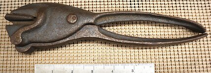

Cleaning out the garage finding tons of stuff I forgot I had ..... and throwing much of it in the garbage when I haven't touched it for many years.
I came upon this set of pliers ... or crimpers ... or cutters... metal roofing shears ???
They look like they have a specific purpose but it's nothing I can recall.
Anyone seen these before ?

Thank you all for solving my mystery ..... I do not remember where or when or why I got them.
neophyte
Apr 23, 2012
9,758
Pennsylvannia
It looks like it might possibly be an older version of the Erdi(Bessey) 32 strapping shear.
That style of handle design on “aviation snips” is more common on German and Austrian snips from manufacturers like Stubsi and Erdi than it is on US made snips, although I think Malco uses a similar design on some of their tools.
Malco does make a double cut snip, but the design is open at the front.
The Erdi 32 appears to have a replaceable blade on the current version, but otherwise it looks somewhat similar, with a single piece lower jaw that is closed at the front.

Ok, that makes sense, that Erdi 32 holds down the strap after cutting, I could imagine the OPs cutter doing the same thing. Thanks
