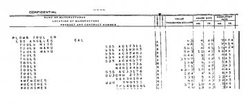

In case you didn't realize it, W535-AC-26577 is a WWII US Army Air Corps contract number. Plomb had seven (7) total contracts with the Air Corps between 1941 and 1945. I will look it up for you later tonight and you can pass the information (exact dates and total contract value) on to your friend if you want. Historical touch points like that add to the allure of a NOS box, in my opinion.

That box is from Plomb's second largest contract with the US Army Air Corps, valued at $3.197M, which ran from March 1942 to November 1943. You can see it about half way down the list in the attached excerpt.

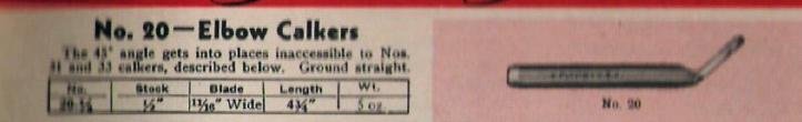

FWIW, I slit most of my NOS boxes open very carefully, making an incision in the packing tape with a very fine, very sharp razor blade, as close to the lid as possible. That way, when the lid is put back on, it's not even apparent that it has been opened. I was afraid that steam would be messier on the glue substance on the packing tape, and, potentially look worse, with the tape hanging loosely off permanently afterwards.
30,981
Haha! It's getting fun now! :)
Interesting approach, bill! However, I doubt the US Army Air Corps was buying elbow caulkers, and I also doubt that the item numbers on Plomb NOS boxes with US Army Air Corps contract numbers correspond to the tool numbers in a Plomb commercial sales catalog. More on that point, if you look at the last NOS US Army Air Corps box I had, photo in post #12 on page 1 of this thread (linked here), you can see that it's marked "ITEM NO. 7." There is no No. 7 tool listed in the plumbers area of a wartime era Plomb catalog, or in any other area, for that matter, and, note that the box to the best of my recollection contained a dozen WF-11 (1/4" service opening) sockets. I could be wrong, but I believe the item numbers correspond to some Air Corps list. Lastly, unless Jabberwocki measured wrong, at 4-3/4" long, they'd have trouble fitting in a 4-1/2" box.
