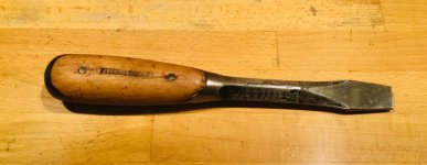

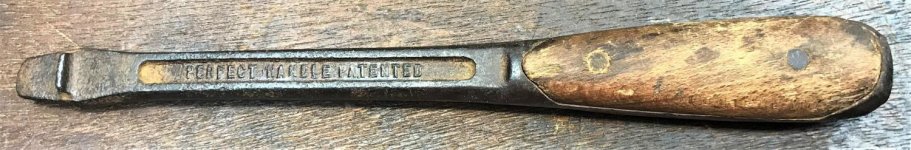

Here is one that I’ve never seen before. It’s not mine (yet:))
Is this rare and quite valuable or just rare and barely worth more than shipping cost?
One side says:
?ANDS & CO PLANTSVILLE CONN. U.S.A.
I can’t make out the first letter or two. Worn off?

Marking H.D.S. & Co is H.D. Smith. They owned the "Perfect Handle" name and patent. If you search on H.D. Smith you will find plenty info right here on GJ. I have seen that particular shank before, but always for more than I was willing to pay. Nice find.
F124C
Aug 19, 2013
1,829
Ireland
Anyone know what is the purpose of the 2 bumps/protusions near the blade tip?
