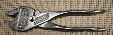

And another 7" Plierench! All my others but these two latest are the bigger 8-1/2" or 9" versions. Earlier this time as it's marked "Eifle-Geared Plierench, and is a more standard configuration. Still in the Amrican Plierench Corp era of 1938-57 though:
The New (older) markings - I'm noting that after the 7" it also has a '42? date markings? and a $4.50 price still stamped:
And I pulled them all together for a "family Photo" - at least 3 generations here:
And other markings from my older pair - third from the bottom, and the pair of Vaco's that has the extra long jaw -that cannot be set for a full close. -which I find odd.
Now American Plierench according to Lugz's table is 36 8-57 and these have a ""36" (which would have been out of the date range prior to correction - see Lug's post below), and I'm noting this pair has a -possibly hand stamped - 68 under the Mod. and that is also out of range...
So Maybe it Mod No. 8-1/2"-'36 << Likely a date - needs more corroboration
and the 7" pair is (Mod. No) 7"-'42. but that apostrophe seems like a "Year" marker '42 = 1942... :dunno:
It is interesting how it states it is a Gr 10-1 for gear reduction - Added note 8-1 on the earlier 7" I posted, with an Arrow from the "Geared" :see:

Now American Plierench according to Lugz's table is 38-57 and these have a "36" which would e out of the date range, and I'm noting this pair has a -possibly hand stamped, 68 under the Mod. and that is also out of range...
That marking is clearly a '36, which prompted me to do another series of Google Books searches, which turned up an ad for American Plierench Corp. in 1935 that I had not found before. It looks like Flash Sale Corp. ended in 1934 and Amer. Plierench started in 1935, a couple years sooner than my earlier research indiciated. I have adjusted the table.

I have three Eifel's. First one is the older Eifel-Flash. The rest are the newer American brand. Shown below is the Flash, then one with all the jaws and canvas pouch, then a loose one will all the jaws, and finally a set of jaws. Looking closely and comparing, I have found some differences. First is that the jaws from the American will not fit the Flash due to a longer lug at the end (circled in red). The Flash did not have any extra jaws, but comparing the three Americans I noticed a difference in the tube cutters. They all have the same diameter pin for the cutter. The cutters have different hole sizes. The way the pin is secured is different between the three. The first one to the left uses a straight pin with a small pin on one end. It goes into a stopped hole and a screw then keeps it from sliding out. The middle one uses a pressed in pin with multiple splines. The right one is like the middle one but only uses two splines. Then I have one loose main jaw with angled teeth. Not sure if this was a later development or not. (Note: I see where it is mentioned in the 1932 patent).

I have three Eifel's. First one is the older Eifel-Flash. The rest are the newer American brand. Shown below is the Flask, then one with all the jaws and canvas pouch, then a loose one will all the jaws, and finally a set of jaws. Looking closely and comparing, I have found some differences. First is that the jaws from the American will not fit the Flash due to a longer lug at the end (circled in red). The Flash did not have any extra jaws, but comparing the three Americans I noticed a difference in the tube cutters. They all have the same diameter pin for the cutter. The cutters have different hole sizes. The way the pin is secured is different between the three. The first one to the left uses a straight pin with a small pin on one end. It goes into a stopped hole and a screw then keeps it from sliding out. The middle one uses a pressed in pin with multiple splines. The right one is like the middle one but only uses two splines. Then I have one loose main jaw with angled teeth. Not sure if this was a later development or not. (Note: Looking I noticed it was mentioned in the 1932 patent).
Oops, ran into a 10 picture limit. Here is the jaw with angled teeth.
