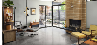

I realize I’m probably a small minority, but I love concrete floors in houses. My wife and I are big fans of mid-century modern/brutalist architecture and are doing radiant heat concrete floors in the residence of a property we’re currently renovating. There’s a tool called a “Diamabrush” that fits on floor buffers and does a great job of cleaning up adhesive and other imperfections in concrete. My local Home Depot rents them. Additionally, me personally, I wouldn’t use a solvent based sealer in a house. There are many good water based products that won’t kill you with off gassing.
I'm an MCM fan too, but I can't say I've seen any originals with bare concrete. Terazzo maybe, but holy smoke that is expensive.
Terazzo was a popular flooring in MCM houses, but concrete was also common. Unfortunately most MCM houses were altered over their lifetime and in many instances concrete floors were covered with other materials. Not my pic, just an example
