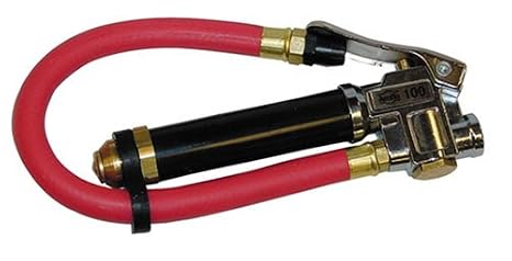

I received one of those trigger type tire inflators with an analog gauge as a gift. While I appreciate the gift - it's a bit on the cheapie side. But even so I've grown to where I like it for inflating tires, seeing the pressure and even deflating a little - very handy.
The round analog gauge itself leaves a lot to be desired. The scale is much too large a scale - up to something like 150 or 200... too high scale to accurately read at street tire pressure levels (or easily read at my age w/o glasses) And it's not all that accurate compared to plunger style gauges or the build-in tire pressure readings on the dash.
I was thinking of simply unthreading the gauge and replacing it with a gauge that is say 0-60 and hopefully more accurate (or that I can readily calibrate)
Anybody done this? - thanks
Mine looks to be pretty much identical to this - just different colors:
Here's a 60PSI gauge for about $12 for example: (would need to check gauges)

PSI is PSI. It'll only read what it's fed. Go for it. Some light truck tires are higher than that though, FYI.

Mechanical gauges are most accurate around mid-range. That cheapie might be 2 psi either way. You get what you pay for. You might consider something with a 3 or 4" dial for easier readability, or go digital.

I had/probably still have, an inflator like your pic and fitted a lower pressure gauge like you mentioned, worked pretty well, though I seem to remember it wasn't std pipe thread as mentioned. BUT, a couple years ago I got an Astro Pneumatic digital, not ever going back. The Astro has a clip on coupler, LARGE easy to read display that reads to tenths of a pound, think it even has a light, which I haven't needed. They keep coming down in price, less than $60. now, great buy IMO, I think you'd be just as happy as me. Battery life is excellent as well, use it a few times a week, still on original batteries.

I've done exactly what you're talking about. My inflator is similar to the one you show, a blue Campbell Hausfeld from walmart. I put this Longacre gauge on it. I put the chuck on a whip with a quick connect, and made two more whips with different chucks. It's been a great little system.

You might find a better deal but what you propose is completely feasible. As has been mentioned, just make sure to match the NPT thread. The gauge is the expensive component so there isn't a whole lot to be saved if yiu have to buy a gauge to make a better inflator.

mine did not use the same threads as the replacement gauge I bought. This was noted above and should not be overlooked.

I've wondered about digital - they must include an A2D converter - so I assume they can only be as good as their A2D. And is an A2D any more accurate than an old school 'A' needle gauge? I dunno.
My dash and my old pencil-type gauges all read close enough for my needs - within 2-ish PSI of each other. My inflator reads way off - maybe 8PSI too high. And it's difficult to read of course - heck the needle is probably almost 2 PSI thick! So one way or another - it's gotta go - either the gauge or the whole inflator.

Be a shame to destroy a nice 50psi analog gauge by hooking it to a 125psi compressor.
Go digital for the best accuracy & resolution across a wider range.
