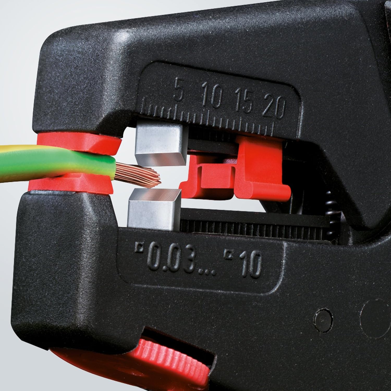

Thanks. That looks a lot like the pressmaster (my post above) and knipex - https://www.amazon.com/dp/B000R895YM/?tag=atomicindus08-20
Looks like the Knipex has a solid flat blade.
The Pressmaster has a solid circular blade.
The Weidmuller uses an array of spring loaded "plates" I'd guess you'd say. They deform to the wire diameter.
I do have to say that I tried my Weidmuller on some 12 AWG I had laying around and the strip isn't the cleanest. For the thicker insulation wires, I prefer to use my Jokari spinner. Spin back and forth once then pull.

I'd give the regular Knipex automatic strippers a try (12 62 180). They're a little more stout than the Felo strippers, and will probably work a little better for you.
If you still feel those are lacking, I would step up to the Knipex 12 40 200. I think they're more awkward to use, but they do seem to be more capable.
I own all 3, and use the Knipex 12 62 180 90% of the time. Its a very well made tool.
