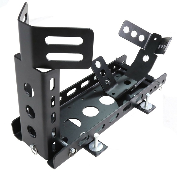

To help me pack more motorcycles in my workshop I tried mounting a Condor roll in chock clone to a Harbor Freight sidestand dolly, with the sidestand pad removed. I was thinking holding a bike upright instead of having it on its' sidestand would save space.
This $30-55 used on Craigslist
i.php
Plus this $75 on Ebay
and you get this
i.php
Completely stable. Makes it easier to pack bikes closely.
The pins which mount the rocker and vertical stop are too wide to fit in the channel of the dolly so you need to either cut them down or replace them with steel rod the width of the channel. When the chock is mounted in the dolly channel, the channel prevents the rods from coming out.

I was worried about it possibly being tippy, so I put the first one together and tested it. The only way I could see tipping one over is to catch both sets of wheels on the same side of the dolly on a crack while pushing the dolly sideways. Hit a crack with one wheel and the wheel stops and the dolly pivots around it. Hit a pebble that jams a wheel and the wheel skids. The real thing you realize pushing a bike around on one of these is you don't want to push too fast, because once you get all that weight moving, stopping it without brakes takes a bit.
I regularly put all sorts of rare classic motorcycles on these. Right now there is a Bimota KB3 and an SB6R sitting on a couple of these dollies in my shop
I've looked at the Condor stuff in person and it is overkill for my use. I'm a sportbike guy. My heaviest bike weighs a little over 500lbs. I don't need a dolly built to hold and move around 1000lb bikes. OTOH, I would guess if you replaced the casters on this dolly with larger ones it would do quite well with a 1000lb bike.

All I can say is, I put together what I put together and it is stable and not tippy. I don't worry about putting anything i own it. If I thought it was sketchy and not worth doing, I never would have posted this idea.
Your concerns are duly noted. I had the same concerns and tested to see whether they were warranted or not. In my experience they are unwarranted.
My average cost for assembling one of these is about $130. So $265 saved over the Condor. I've made 5 of these dollies. so $1325 saved. I own what I own, because I maximize my income and minimize my expenses. This project was part of my continuing attention to minimizing expenses. For the potential savings, it was well worth paying the $130 to see whether it would work well or not. Others may see this the same way, and of course you may not.
