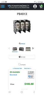

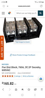

A Polaris connector to get down to a smaller wire size for the connection.
Wow, looked up the pricing for that size and they may be what you already mentioned. $105 each
Could do a split bolt and the right tape. That'll be a ton cheaper but more work
Sure, but here's my question. What sort of panel has lugs that fit up to 250 MCM, that has enough space to handle 750 MCM and associated upsized conduit? And if you think $105 Polaris connectors are expensive, wait till you price out the upsized 1000A panel that has room for 750 MCM (not to mention the cost of breakers to fill it).
