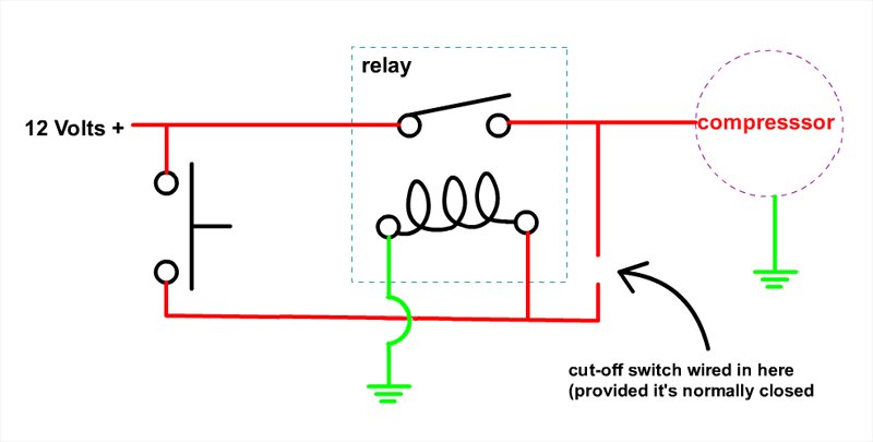

Hi all, I am doing some winter mods on my Street Glide. One of which is rear air ride. I have a kit that includes a "ride height repeater" basically two pieces of aluminum that slide together and when the rear bags reach a certain length of extension, they bump a small disconnect, cutting power to the compressor. This is supposed to give you the same exact ride height every time.
My idea is to use a factory momentary switch on the dash, press it once ( do not hold down ), this powers the compressor up and starts pumping the bags. Then the bags reach the determined ride height and the disconnect cuts all power. There is also a master power on/off push type switch, as well as a momentary dump valve switch.
My question is how can a momentary switch be used in this application to deliver constant power until the disconnect cuts power. Mind you the compressor is very small and would only run for a minute or two max.

Use the momentary switch to operate a double pole relay. One set of contacts on the relay will latch the power on to the relay, the other set of contacts will operate the air compressor.

The basic circuit is this "seal" circuit.
In your case the momentary pushbutton is same as "start", the limit switch with a normally closed contact would be same as "stop", the circle labelled "40" is the relay coil and the -40- contact is a normally open contact on the relay.
More or less, the start pushbutton, depressed for an instant, energizes the coil of CR40 and this closes the ][-40- contact, all happening at the speed of electrons in copper wire. By the time the pushbutton is released the ][-40- contact is completing the circuit left-to-right instead of the pushbutton. This will maintain until the ladder power is dropped or the "stop pushbutton" or in your case the limit switch, changes states.
The parallel sides of the "ladder" are +12vdc on the left and -GND on the right.

Here is a simplified version but with out knowing how its actually wired and if the limit switch (disconnect) is on the positive and normally closed. It can be done simply but we would have to see the wiring diagram for the system.

No, it's not missing anything, connect where it's open for the limit switch (black arrow) and it latches.

So here's a sketch with what I have. The limit switch is open when there is no air in the bags, when the rear is aired up, the switch closes at a preset height. This shuts the compressor down.
Once again there's a on/off switch I want to use as a "master" power. That way it kills power to the compressor so the bike doesn't air up unintentionally while going down the road or sitting. JUST incase the air bags were to ever leak. The two momentary switches are to kick the compressor on using the dpdt relay as well as operate the solenoid to "dump" the air from the bags. The idea is to click the master power switch on, press the air up momentary once. The compressor will then start filling the bags until the limit switch closes and shuts it off.

You need to do the self-latching part, which means the power between the limit switch and the compressor is what holds the relay on. When the limit switch kills power to that section, the relay drops out. I'll call this the LS+ wire.
Also you need to show the power to the controls, just for completeness' sake.
For instance: B+ to the left side of the master. Green from the right side of the master to the input of the two momentaries. For this purpose, put the dump wire at the top so it doesn't have to cross anything else. Also run B+ to a relay common and from the corresponding NO to the limit switch. Then your momentary 'on' and the LS+ wire will both feed the coil+. When you press the button, the relay triggers, limit switch allows power to the compressor and maintains power back to the coil until it drops out.
The only weakness I see in what I've proposed is that the power switch won't kill the system if the LS goes bad; you may need a second relay for that. But draw up what I've said so far. Also, you can get rid of the black wire in the diagram and just show grounds at all of the ground points. Cleans things up a bit; we're really just interested in the switched positives here.

I think this is what you need to do. Note that I'm assuming the "dump" solenoid switch can handle current and only needs to operate when switch is depressed. You may need to run it through another relay if this is not the case.

And instructions say that the switches without a relay are for 2amps and below. The solenoid is undoubtedly more than that so a relay will be a must for the solenoid as well as the master power.
Then just add another relay.
- Power from Battery+ to dump switch and and relay pin #5
- output dump switch to relay pin#7
- relay pin #8 to ground
- relay pin #3 to solenoid +
- solenoid - to ground

The thing I don't like about that last diagram is that at the instant you press the fill button, it's carrying the full load to the compressor. After that the relay takes over. I think the way I described it the button only triggered the relay. It's better to separate the functions: button controls relay, relay controls compressor. That way when one component fails you don't get some unintended consequence.
cgrutt
Mar 4, 2016
8,270
Pretty sure a magnetic starter is configured the same way and relay "delay" is nearly instantaneous. However, you might add a diode between pin 3 and the limit switch to isolate the current on start/stop (air/limit) switches to the coil if it helped you sleep better, lol...
Other option is to run limit switch on other side of relay, between pins #4 and #7. In this case you also need to run 12V+ (from output side of master on/off before run switch) to pin #6.

I tried to revise it this evening between classes.

Looks good. You omitted B+ feeding the master, and 87 feeding the other two switches, but you know that. Also, the way it's wired you will get compressor when you push the button even if the limit switch is made, but I don't see that as a problem.
