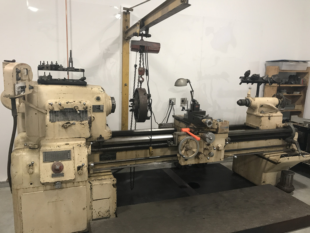

Plastikosmd
Nov 17, 2016
1,254
Did similar biggarage^
I upsized a required beam to handle an additional 1ton moving load. I then also had to instruct the plaster guys to not box it in (several) times
Very handy (one manual chainfall, one air power hoist)
Also a smaller rolling one (manual) and a swinging (electric) over my bigger lathe
