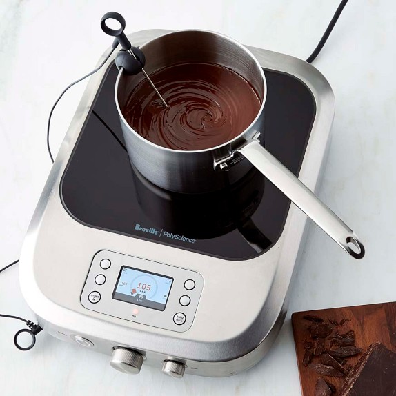

downward adjustments on induction are faster than they are on gas. copper cookware works just fine on induction. it doesn't have to be ferrous, it just has to have magnetic properties. like the copper windings in an induction motor.
I'd be happy to make pecan pralines on this:
my $60 amazon induction hob has temperature control, but it's terrible. controlling by wattage is pretty close to gas behavior. it makes cast iron feel way faster.

I got one of these. it is so much faster than before. but even this is only 30% efficient. a flat bottom pot was like 10% efficient. and I don't really care about the dollar value here, I care about my TIME. waiting 30 minutes for water to boil is really annoying.
induction cookware that is "less efficient" will actually pull less power from the wall on the same setting. I played around with mine plugged into a kill-a-watt.
That's interesting... I need to think about that for a bit (or go back to school and re-learn most of what I forgot).
