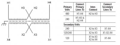

Bert_
Dec 24, 2016
9,920
NW Iowa
Okay, now do I have it correct ?
What you have drawn shows the primary side wired 480. You need to connect H1 and H3 then H2 and H4 for 240v input.

wyliesdiesels
Aug 14, 2012
20,258
Modesto, CA
no still not correct. the high side shows 480v 3 phase. It needs to be 240v single phase with one coil not 480v 3 phase open delta with 2 coils. There should only be A and B

ok disregard my comment about the 4-wire panel being incorrect. I misread your diagram
So you need to add 2 ground rods at each panel since theyre all in detached structures.
run 4-wire feeder to pump house, put 2 ground rods in and change breaker for 120v outlet and you will be good
theoldwizard1
Feb 22, 2011
43,636
SE MI
what are you using to draw these transformer diagrams?
I stole the original off of the Acme Transformer web page and have been modifying it.
Clearly I grabbed the wrong drawing to begin with !
