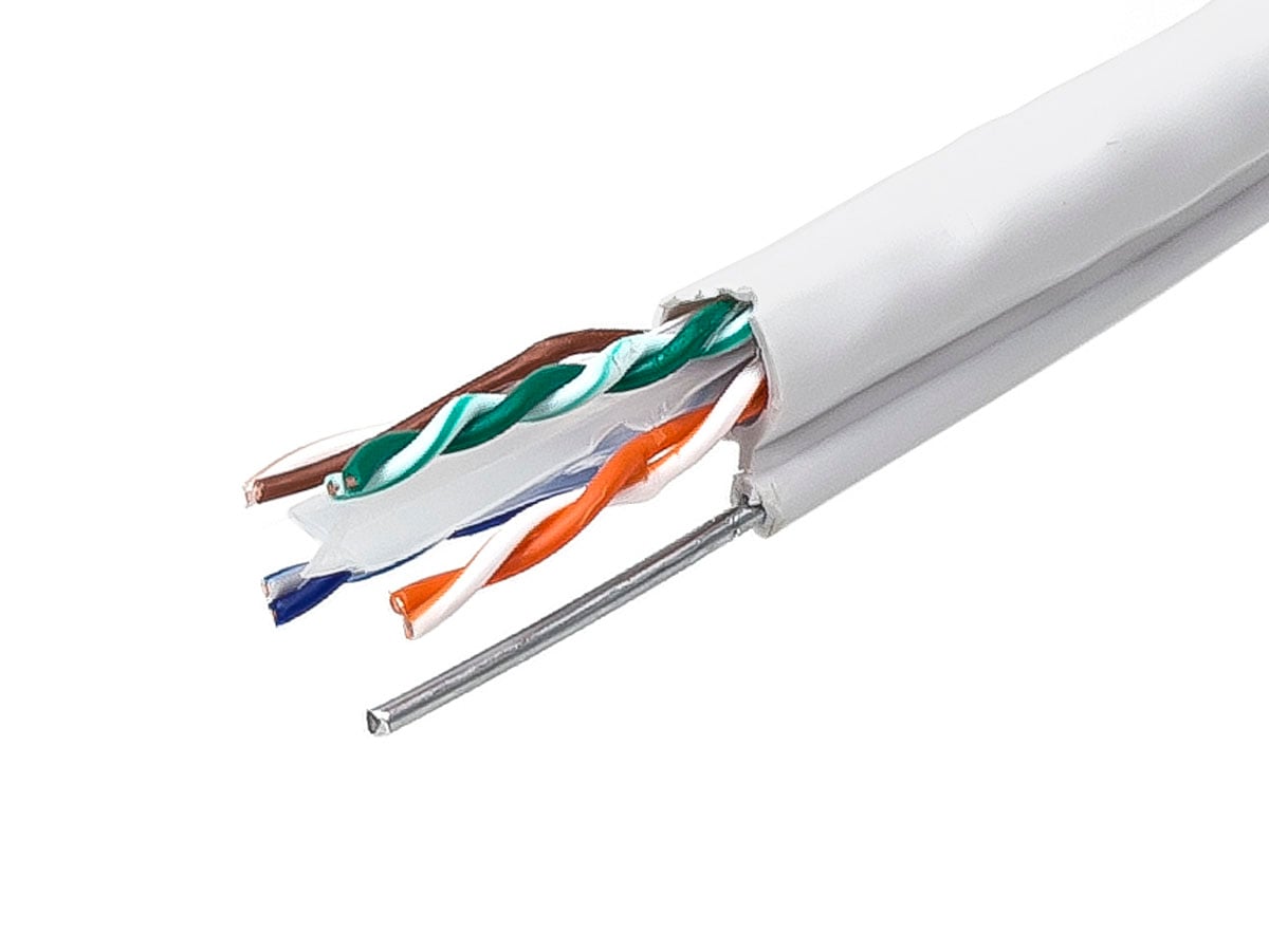

.....But FWIW, given the 90-foot (one-way) distance you later mentioned, that should be good for up to about 125 Amps; if we presume another 10 feet on each end to account for the vertical segments and similar, make that about 100 Amps.
presuming conduit, I would use outdoor-rated cable, such as:
http://www.monoprice.com/Product?p_id=8115
Huh? Not sure what your getting at with 125amps being good over a 90' distance. With what size wire? huh :dunno:
And I wouldnt run just ANY outdoor rated wire underground. Gel filled CAT5e, aka 'slime wire', is what SHOULD be used for underground environments, especially conduits, which are likely to fill up with water. It is a b*tch to work with, however! Dont forget the gloves!
http://www.primuscable.com/store/p/...Ethernet-Cable-for-Networking-1000-Black.aspx

The wire you posted from Monoprice is NOT direct burial wire. It's for use overhead, that's why it has the attached messenger wire.
You would need gel filled cable to run underground.

For ethernet, Cat6 will go farther than Cat5 because it's a bit bigger: 23 ga vs 24 ga. Not much, but it can make the difference, especially when running POE devices.
Cat6 also carries wider bandwidth, but for most networks that doesn't matter (although that is changing!)

Negative batman. CAT5e and CAT6 have the same maximum 'allowed' distance which is 100m or 330'. Now i have ran cables longer than that without issues but when it comes to PoE devices, lengths over that usually does have issues due to voltage drop and lower power delivered to the device.

Allowed distance takes into account bandwidth. IF you only need the bandwidth of Cat5 or less, using Cat6 will give you a bit more distance. (notice the technical term "bit") :rolleyes2
