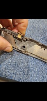

Utility knife blade carriage too loose

Aren't you missing a spring?
No spring
Finn is spot on with the idea to shorten the screw. I'm at work so no access to grinder but wedging some paper between the two halves of the handle allowed me to get some friction on the carriage
Works like new now

Do the two halves touch each other with the screw tightened?
The end of the blade holder with the button should have a t-shape to that locks in the notches on the body halves.

I have folding knives for some stuff but working one handed, a retractable blade is much easier to use.
As asked above, is the case closed up when the screw is tight? Or does the screw bottom out before? Can't tell for sure from the video but it looks like the case has no gap. If that's the case, I don't know what you think would be gained by tightening the screw more. Take a pic of the knife with the blade in place but one side removed.
Each brand has some differences, but the little t shaped section at the back of the carrier should engage the notches in the case. That usually means the little thumb thing is sticking up so you have to press it down to clear the notches. It looks like the thumb thing is bent downward on op knife. Here's an example of how it normally sits proud of the knife body.

There has to be a spring , maybe not a coil type but could be a flat spring. Has to be something in there that pushes up on the lock to engage the detents in the body.
I've never seen one that relied on friction.

Looks like a Stanley self retracting knife model 10-189 I think. The spot where the blade carriage attaches to the spring breaks after a few years of daily use. These should be covered under warranty but my local big box stores no longer carry this model.

No spring
the thumb tab will have a flexible "spring" so it pushes into build in detents, thus locking the blade in place.
I'd like to see pictures of it opened up. the screw mysteriously getting too long isn't making sense to me. I've worked with those kind of knifes a good part of my life and worn out more than I care to try to count .
edit. I just watched your video, the screw too long is not your issue. the mechanism is fubared and not locking

The thumb button is the wrong shape for a locking blade. Likely self retracting.

You mean like every time you push on the blade it retracts? I've had a few like that, but only for long enough to find a responsible place to throw them away.
I have a half-dozen styles of various brands of ute knives around the brewery. All have a locking mechanism of some very simple type--like the Stanley 99E in my pictures above.
It would make things easier if the PO had shown more of the knife than just the Stanley logo.

Bend up at the arrow:
so the T end engages the slots:
or just buy a new one.
Ha , took pics of mine and got busy, forgot about this thread.
First 3 pics are a Stanley which has a flat spring.
The other pic is a popular mechanics and has a coil spring.
Regardless, there is some type of spring in there, as has been mentioned.

As stated in post #15, this is a self retracting blade knife. I had the same one, hated it and gave away.
This one is broken, clamping the case halves tighter wont cure it.
IMHO toss it and buy a 77 if you want retractable blade.
