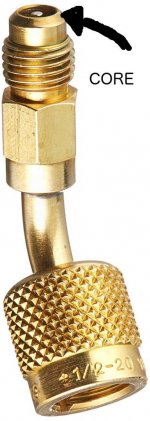

For a mini split you almost always need to use a 5/16" female to 1/4 male" so regular hoses can fit for evacuation..
on this adapter made by YJ, is this a schrader valve core? Do you recommend to remove it first so it doesn't have to vacuum thru 2 schrader valves including the one on the service port?
Do you remove it using a tire core tool?

That tool is very useful in replacing a leaky valve core on a fully charged working unit with minimal refrigerant loss and also very convenient as you don't need to recover and recharge a working unit just to replace a leaky valve core.

I guess I will just keep it on there. I am not pressed for time and I don’t want to deal with using a core removal tool
