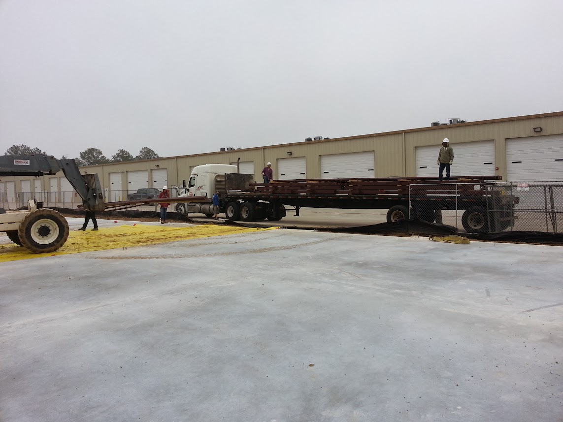

Looking at garage floor options here is the slab:
BhRWZ86QFe1UQ3Dc6ZDfGL5kOXMWeprIyokMTF-R4kU=w1143-h857-no
1720sqft
The garage will be used for cars, motorcycles, sometimes trailers parked inside, i will likely have a forklift for picking up and moving heavy things as ones back doesn't need to do this..
anyone chime in on a VCT floor and how it will hold up?
