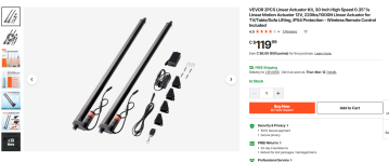

I could buy some linear actuators like this:
And use them to close a plywood/foam insulated door over the standard louver vent fans.
This style and cheapness:
That is more screwing around but I bet I can make it insulate about 100X better than just the motorized louver versions for about 1/4 the price. :dunno:
In an old shop of my brothers we used an attic fan that had automatically opening insulated doors (shutters?) for venting. Mostly because it was free, but it worked nice and was insulated pretty well when closed.
