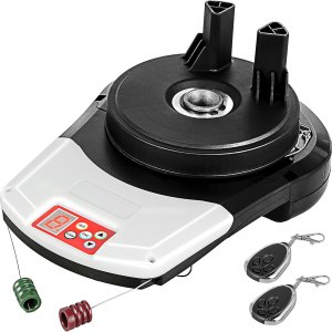

Has anyone installed one of these garage door openers? Thoughts on how well it works? I have a 10x10 door that gets the most use since its for the bay that has my lift installed. Was thinking it would be handy to be able to open and close it with a remote.

Yes for roll up doors. I have 2 - 10x10's on my shop. They are the lower cost "storage building" type doors, but have a full drum and chain hoist. They work good and I am happy with them. My shop stays closed up all the time as I have a/c and insulation. When I bring a car out to work on it, I drive over to the shop, get out, open the door, get back in, drive in, and close the door. I try to do this in a quick fashion so I dont let all the a/c out. Just thinking for $150 it might be more convenient to have a opener on the one door so I could just pull up and drive in.
In the review section there is some good pictures and descriptions that people have done to show the modifications that may be necessary for different door drum ends. Got to go up on a ladder and do a few measurements but it looks doable and seems to get favorable reviews from real people (I think).

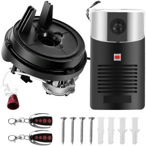

I just purchased on on eBay. Im in the process of modify it to fit my roll up door.

I started working on my install but haven’t finished it yet. I used a piece of 1x2 tubing mounted to the end of the drum for the drive and made a bushing to fit the shaft thru the drive. Hopefully will get around to finishing it up soon.

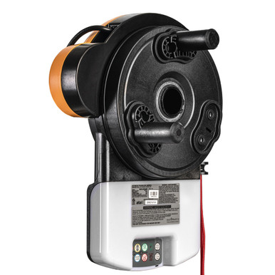

I went with this one:
It was an add on option when I ordered my roll up door. Very high quality and great tech support from the company. (I dropped the door while installing and broke the opener housing. They sent me a new housing for free no questions asked.
My neighbor has the Vevor he installed last year and has no complaints.IMG_5687.jpeg

I hope to get back on it soon. I kinda had everything figured out and then "life" happened. The 1x2 tube is going to work perfectly. The "drive" ears on the opener will have to be trimmed off shorter because they are designed to go thru holes in the door end. I have to move the door shaft support bracket to compensate for the thickness of the operator. All pretty easy things that just take some time to work out. The one thing that slowed me down was the seal that I have at the top of my door opening. I used one of the wide rubber ones that sorta drag on the door as it goes up/down. I feel like that is going to cause an issue so I was in process of trying to figure out what to do. Might change it out for a brush style. Basically wanted to get the doors "tuned" so that they go up/down easily without any hangups.

I too went with the Automatic Technologies opener.
GDO 12 with the 1400N DC motor. They recommended the bigger one for the 2500 series doors and mine are 14x14 insulated.
About 8x the cost of a vevor though.
But for a 10x10 door in the OP I would probably try the cheaper vevor. Not much to throw out if it doesn't work out or is finicky.
