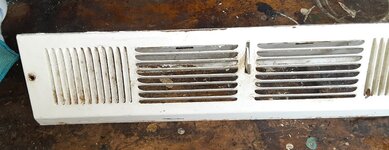

I just bought a creworks 15L on Ebay for $170.00 delivered (seller premiumautopart). I expect it here Saturday. Now the 1st project is going to be removing paint from air/heat vents. They were painted with a brush and look like ****. I have read of people putting thing in jars and ziplock bags. My question does it madder if the bag is black? These vent are 18" long, And obviously won't fit in the machine. My plan is to coat them with industrial strength pain stripper, add Simple Green Pro HD, friendly to aluminum, and water. Tie the bag off, and get them in the machine, as best I can. Thinking of running the heat at about 90°, since the lid won't be on.
I open to any suggestions!

Why do you need the ultrasonic cleaner? Just use the stripper like a normal person.

It is very hard to get into the fins of the vents! I did 2 by hand and took forever! As I said this will be the 1st project. I do have a lot of other thing to do with it. I mainly want to know about using a trash bag.
Brush on the stripper, let it be for an hour, wash off with hose or in the sink. Or in the shop dishwasher.

So the cleaner came yesterday. Today I put a heavy coat of said stripper on the vent, and put it in a trash bag (32° here) and brought it in for about 1 hr. photo 1. Filled the largest jar I could find (plastic), with hot tap water & dawn and Simple Green Pro HD. Ran 2 15 min. cycles photos 2&3. Came out just okay. Than I used 3 cups Simple Green Pro HD, 3 cups Purple Power, a little less than 1/4 cup paint thinners, hot tap water couple dashes dawn. Ran a 15 min cycle & a 25 min cycle Photos 5&6. I was shocked all I did was wipe it with a rag and small copper brush.
First attempt with a ultrasonic cleaner SUCCESS!!!
