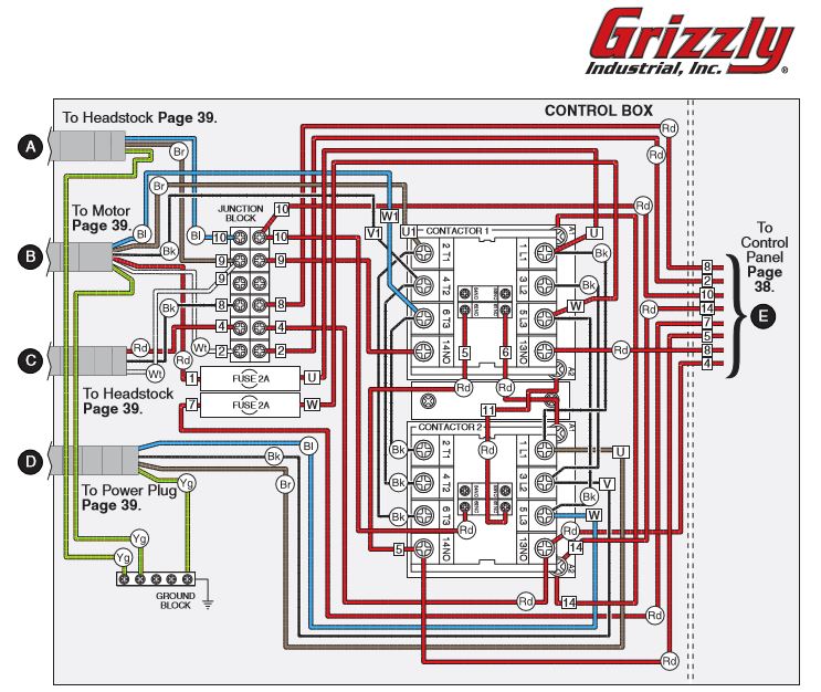

>To start off, I know next to nothing about electrical.
They are industrial controls, requiring some industrial control reading to config. As hinted above, a VFD can only power the motor directly. You're control wiring will need to be stripped out and wired back to the VFD control inputs, then the VFD programmed to respond to the control inputs.
Example - my Griz G0519 mill
As wired from factory:
After installing VFD
> From what I'm reading I'll have to get an actual phase converter and not the VFD if
>I want to run just the individual power cord.
This is correct - unless you want to re-wire the machine controls, you need a phase converter. And not that the static phase converters fall about 50% short on power from what I read. So at least double the size you think you need for a static.
