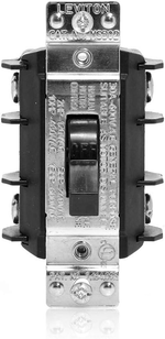

The Leviton MS-302 switches 2 poles.
That's a good choice, but it does need an oversize J-Box. Thread about it here:

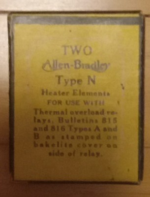

I recently bought this at a garage sale not really knowing what to do with it. I'm guessing this would work as a whole unit? Do I need anything else to go with it?

That looks like the one in the post below, just different color?
Nope, according to that post, the red one is rated for 1 HP. It is physically smaller etc. I think you have a 1.5HP motor.
But as others have said, your motor is not thermally protected. So it was designed to use a motor starter with thermal protection.
Like the one you found at a garage sale. You will need to install the correct size heaters (amperage) for your motor. The N25's that are in there are not rated for the motors amperage.
Oddly enough, the yellow sticky note in your photo says N30 - and that may be correct for your motor. You need 2. Did the motor and starter come from the same yard sale?

That starter will work with your motor. As noted, you'll need 2 N30 heaters. They are easy to replace.
Do not do anything to the contacts. If you file or sand them, they won't mate up with each other and they'll fail early. The black stuff you see is silver oxide. It is conductive and won't cause any problems.
If the layer of silver is filed off, the copper below it will arc and cause copper oxide to build up. Copper oxide is not conductive.......
If you absolutely must clean them, a basic pencil eraser works best. It'll clean the oxide off but won't affect the mating surfaces.

Heaters are cheap. Look at the chart inside the motor starter. Look at the motor label and see the amps drawn by the motor. Match up the ratings. The N25 heaters will likely shut down your motor well below its capability. Rip a long board and saw trips out when it didn’t need to.
