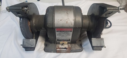

Recently bought this Craftsman bench grinder for $6 but i wanted to add a switch but I’m not sure of the proper wiring and what switch to buy. I’ve looked in other posts that say that you can just cut the black wire and connect the switch in between but I want to confirm first since my electric knowledge is limited.

You can look the grinder up by make and model and see what the original was. No bench grinder was ever sold w/o an on/off sw.
I did look it up, but the grinder doesn’t have any holes/openings for a switch and I’ve read in other posts that they did sell grinders without switches and they were just hardwired.

To answer your question, yes, putting your switch in between the back wire coming from the cord will allow you turn the grinder on and off.
But I am also with Zeke that it seems really odd to build a grinder without a switch. Doesn't make a whole lot of sense to me.

I find it odd and unbelievable that Craftsman supplied grinders without a switch.
but, yes, you switch the black ( Hot) wire. that's assuming the black is wired hot as it should be and if not, correct that too
show us a picture of the front of the grinder, particular the lower portion where switches normally are

Sorry for not responding sooner but I ended up replacing the power cord since it was all busted up and installed a toggled switch in between the hot black wire and it seems to work properly but let me know if there’s anything I can improve in the future since I’m planning on restoring the whole thing. Thank you for all the guidance. I attached pictures of the grinder before I drill a hole for the switch.

if it don't come with a switch, easily enough to drill a hole and put in a toggle switch . and yes, ground the case too .

I don't have a copy of the owners manual for this model Craftsman grinder, but I have see other examples of the 1/4-HP models with out an ON/OFF switch.
0.25 HP m-397.19300 a
Above is a wiring diagram from a 1/4-HP model, showing factory wiring, with white/neutral going to the start-up relay.
Be sure the switch is motor rated.
